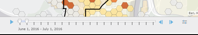

Hi,
I have a web map with a couple of time enabled layers with the display set to 1 month increments. I set the start date to the beginning of month, even though the data actually starts on the 30th. This results in the following being displayed:  Time Slider Display for 1 month
Interesting the month does not end on June 30th.
It gets more interesting as you progress through a year.
And when you get to February
I was hoping the 1 month increment would allow for a actual calendar month not just a straight 31 days.
Any thoughts?

Having the same issue.  I have one set of readings every month to display.  My data all exists on the 1st of each month, but when I set the time interval to 1 month at a time it goes from April 1 - May 1,  May 1 - June 1 etc.  Instead of the end of each interval ending at the last day of the month, it jumps to the first of the next month causing the values for 2 months to display on each interval. Frustrating.
