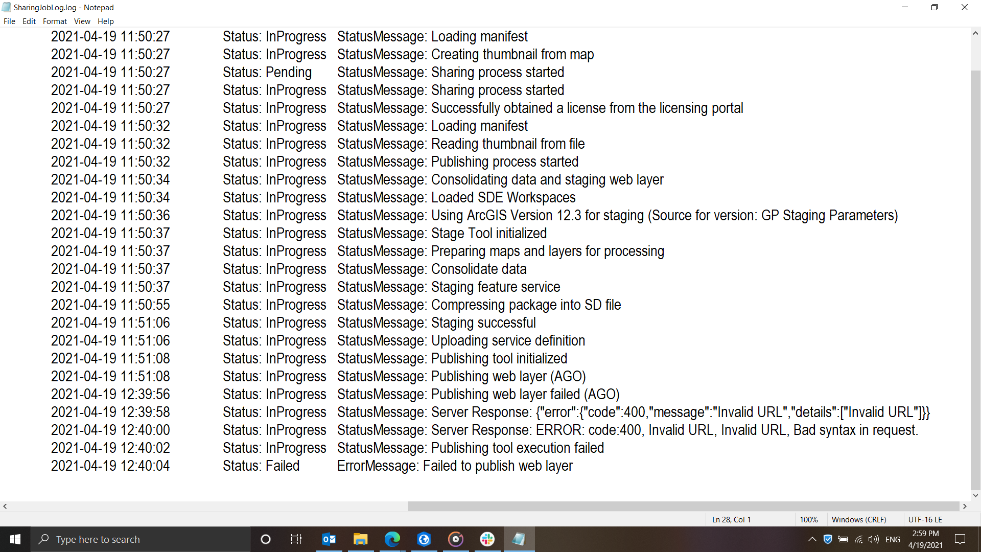

Hello,
I'm trying to publish a feature service containing a feature class and a table from ArcGIS Pro to ArcGIS Online.
The process continues until it reaches "Uploading service definition" and gets stuck for very long time.
Finally it fails giving the attached log.

I've having a similar issue with publishing/overwriting feature services which was working fine before the major update last week. Any chance this could be related to the update?
It seems to be stuck at the uploading service definition file stage and then errors out.
