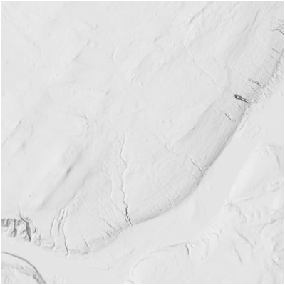

Not 100% sure and you might have to contact support on this but I did take a quick look at the network traffic and I am not seeing any renderering rules being sent when you select hillshade for your service. If I go to the REST endpoint and use these rules under
Export Image > Renderer rules
{"rasterFunctionArguments":{"HillshadeType":1,"SlopeType":1,"ZFactor":1},"rasterFunction":"Hillshade","variableName":"Raster"}
The output I see is this
Hillshade is working on this test service however so i am not quite sure the difference that could be causing the above issue
https://sampleserver6.arcgisonline.com/arcgis/rest/services/CharlotteLAS/ImageServer.
One other thing I noticed in the services was yours has
Service Data Type: esriImageServiceDataTypeGeneric while the sampleserver case is
esriImageServiceDataTypeElevation
