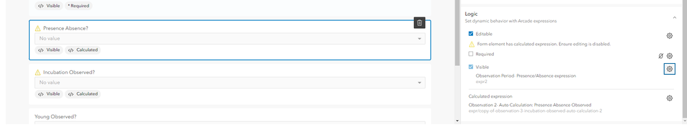

Not exactly sure what you are trying to accomplish, especially the prior observation field, etc.
However, in case it might help, I have tested this arcade with the editable logic:
var arr = ["Observation 1", "Observation 2"]  //  List to compare to
if (Includes(arr,$feature.ObsvPeriod)){
  return true
}else{
  return false
If I have a field that is calculated (and thus not editable) the calculation will fire as normal.  However, if I attach the above code to the Editable logic expression for that field, then, if the values of "ObsvPeriod" are equal to "Observation 1" or "Observation 2", then the field will become editable.  If it is any other value, the field will be populated by the calculated expression attached to it.

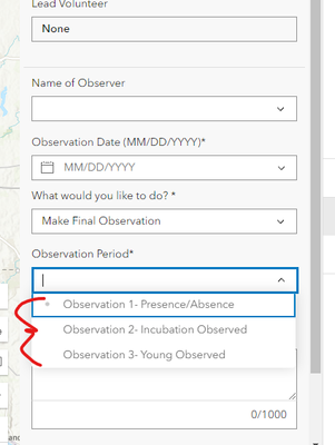

Our workflow- We have three types of observations. These observations are typically sequential in order based on the bird's nesting time-frame and all fields are editable
-but-
Sometimes volunteers don't get to a nest until observation 2 or 3 in which we need the prior observations's fields to to be calculated to our default (use the calculated expression).
I don't see a good way to fit a toggle into this scenario with our workflow. Please let me know if you have any ideas.

Hi @Amanda__Huber , I am not sure I fully understand all the details of your implementation described above, but I'll give it a try.
The toggle itself is not necessary. The bigger idea is that a field can become editable based on a condition expression.
For example, you could have calculated expressions set for all the fields above the Observation Period field. These could be calculated automatically at all time.
Then, you could also add an Editable condition to these fields as well, so that they will become editable if the Observation period value selected is Observation 1.
This means if the Observation period selected is 2 or 3, the fields remain calculated and uneditable, but if the user chose Observation 1, then they become editable.
I hope that makes sense.

Amanda__Huber
MVP Regular Contributor
Thanks so much for this arcade snippet! Sorry for my delay, it's been some time until I was able to circle back around on this project.
I did some testing with the info you provided and this works great!! One thing to note - it appears this only works if 'Visibility' for the calculated fields is ON when the calculation is occuring. It doesn't look like map viewer forms supports hidden field calculations (not the end of the world just annoying.)
Thanks SO much for this assistance, this saved the day for our project!
