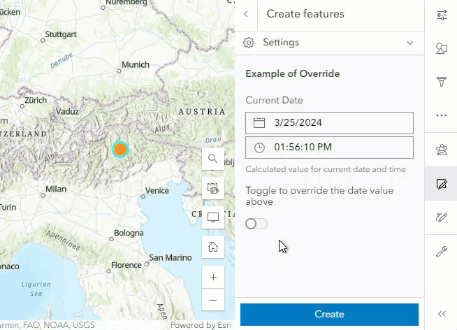

In the provided example, an editable feature layer has a Current Date field for which the value is automatically calculated based on the current date and time. Another field is used to define conditional editability for the Current Date field. If the Current Date field is editable, the date value can be changed. If the Current Date field is not editable, the date value is calculated and cannot be changed.

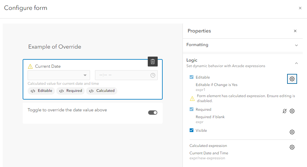

Step 2 - Add the calculated field to the Form
  1. In Map Viewer or the Field Maps Designer app, create a Form for the layer.
  2. To the Form, add the field for which a value needs to be calculated (e.g. Current Date in the sample layer).
  3. Under Logic, define the Calculated expression using Arcade.
    In the example below, the expression Now() will automatically populate the current date and time into the Current Date field.
Step 3 - Add the conditional field to the Form
  1. To the Form, add the field that end-users will use to make the Current Date field editable (Change Date in the sample layer).
  2. Under Formatting, update the Display name for the field (e.g. Toggle to override the date value above)
  3. Change the Input type to Switch.

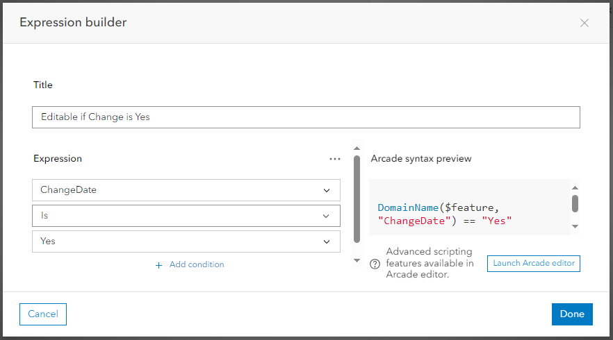

Step 4 - Add Logic for the calculated field
  1. For the calculated field (Current Date), under Logic, check the box for Editable and configure a new expression. (e.g. the Current Date field becomes editable if the Change Date field value is "Yes")
  2. Optionally, add an expression to make the field required if it's blank.
