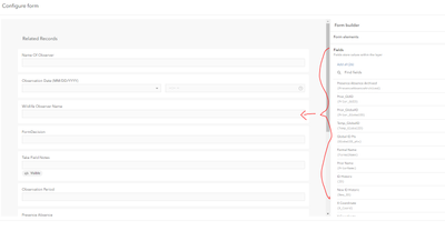

When trying to set up a Map Viewer Form with related tables, 'referenced' feature services with related tables do not show up under the form's available layers when it's in the map, whereas 'hosted' related tables do show up. Below is an example for a hosted service, what we should be seeing for referenced services as well but are not:

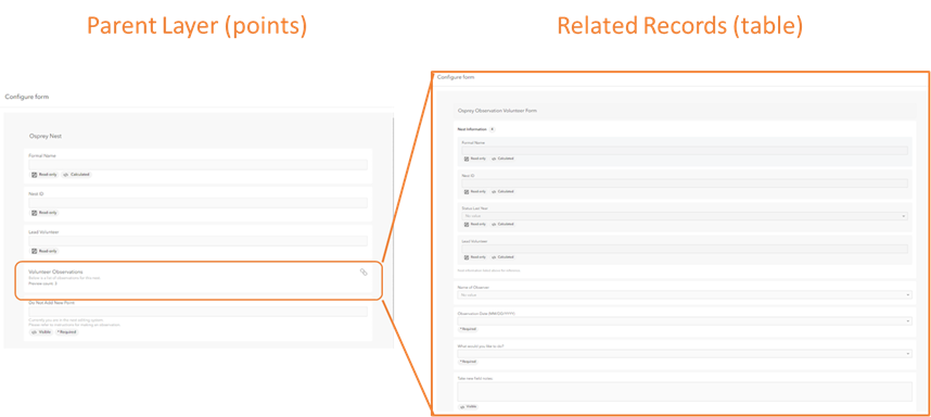

  • Add the related table to the form for the points feature layer (this sets up the form relationship) see diagram below:

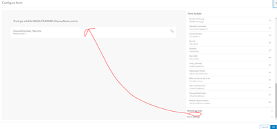

    1. Add the relationship to your parent layer form:
3. Go to the table in the map viewer and add the fields to the related table & configure conditions from here

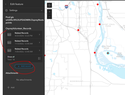

Once you save the map, the related table fields will be visible in other applications when editing the parent point layer's information:
(add new record or edit existing)
