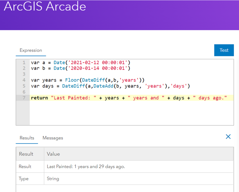

Try changing the inputs about in the arcade playground  ArcGIS Arcade | ArcGIS for Developers and see if this suits:
var a = Date('2021-02-12 00:00:01')
var b = Date('2020-01-14 00:00:01')
var years = Floor(DateDiff(a,b,'years'))
var days = DateDiff(a,DateAdd(b, years, 'years'),'days')
return "Last Painted: " + years + " years and " + days + " days ago."

DavidPike
MVP Notable Contributor
LukeAllen2
Hi David, thank you I think your code is alot more stream lined and I'll use that with a few adjustments to catch those that were painted today, yesterday or  within the same year etc.
Many thanks !
DavidPike
Good stuff, In my head it works conceptually,  (let the datetime module do the work - I'm guessing that's what its based on??) A few If Elses for the formatting and should be good.  I hope the concept kinda makes sense.
