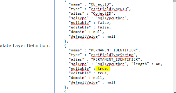

And not all of the changes were good ones. Seems like administrative editing of a service via the REST admin URL has been disabled, didn't see that listed in the new changes? How to reproduce:
Go to
https://services1.arcgis.com/some org code/ArcGIS/rest/admin/services/YOUR_SERVICE/FeatureServer/0/updateDefinition?token=SOME TOKEN
Double-quote the edit date
Change something about the schema:
...and then observe how nothing was changed:

By double-quoting the editdata, I am able to change field alias', but not nullability. From http://blogs.esri.com/esri/arcgis/files/2014/10/How-to-Update-Hosted-Feature-Service-Schemas1.pdf , the chapter Field Properties, it appears that changing the null value is possible, and WAS possible yesterday, not today after the update...
NikhilShampur
Tom,
Updating the nullability of fields via updateDefinition is not supported and never was.
One way of achieving this is to use the deleteDefinition to drop the field and then re-add the column with a nullable type. Note:- This does lose any existing data in the column.
