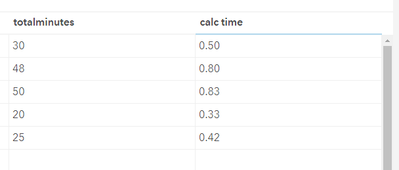

JulietK
Hi Manish,
That worked perfectly, thank you for your help!
