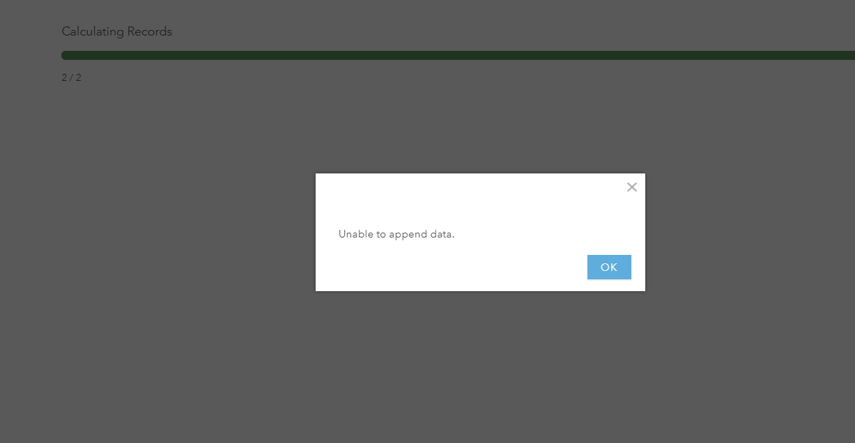

When performing calculation on layers in ArcGIS online using Arcade expressions I am often met with this error message(see image below) .It does not matter what calculation I perform it may be simply entering a single value or more complication expressions. I receive  the messages "inserting" and "committing" and then is fails.What could be the cause of this?

I haven't seen this type of error before. How many records do you have (just 2)? I have been able to calculate many thousands or records and it has been pretty fast. What is the source of the data? What type of field do you have? What Arcade expression have you used? Did you try the SQL option  for the calculation too? Same behavior?

I happen to have just two in this data set as it was a test hosted feature , but this error has appeared over several data sources. This particular field is an integer but again i have seen this error in multiple field types. I used two types of expressions one was simply inserting  a common value of say "2", the other was more complicated  summing the total values  of  a column from another data source, using the feature set function and both failed. SQL option works for calculation , individual edits work and editing via ArcGIS pro also works.

Yes, I have the option to calculate the field using Arcade but getting the same error message as Paul which is "Unable to append data". The hosted feature layer was created in AGOL and coordinate systems is Web Mercator. I was able to complete the same calculation with another hosted feature layer and got the data to append.
