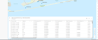

I'm looking to remove the trailing zeros that ArcGIS Online seems to add to every numeric field in my data:
Is there a reason that ArcGIS Online defaults to six decimal places? I see where I can adjust this in field settings, but seems very odd that AGOL would just take it upon itself to reformat the field from what they were published as...

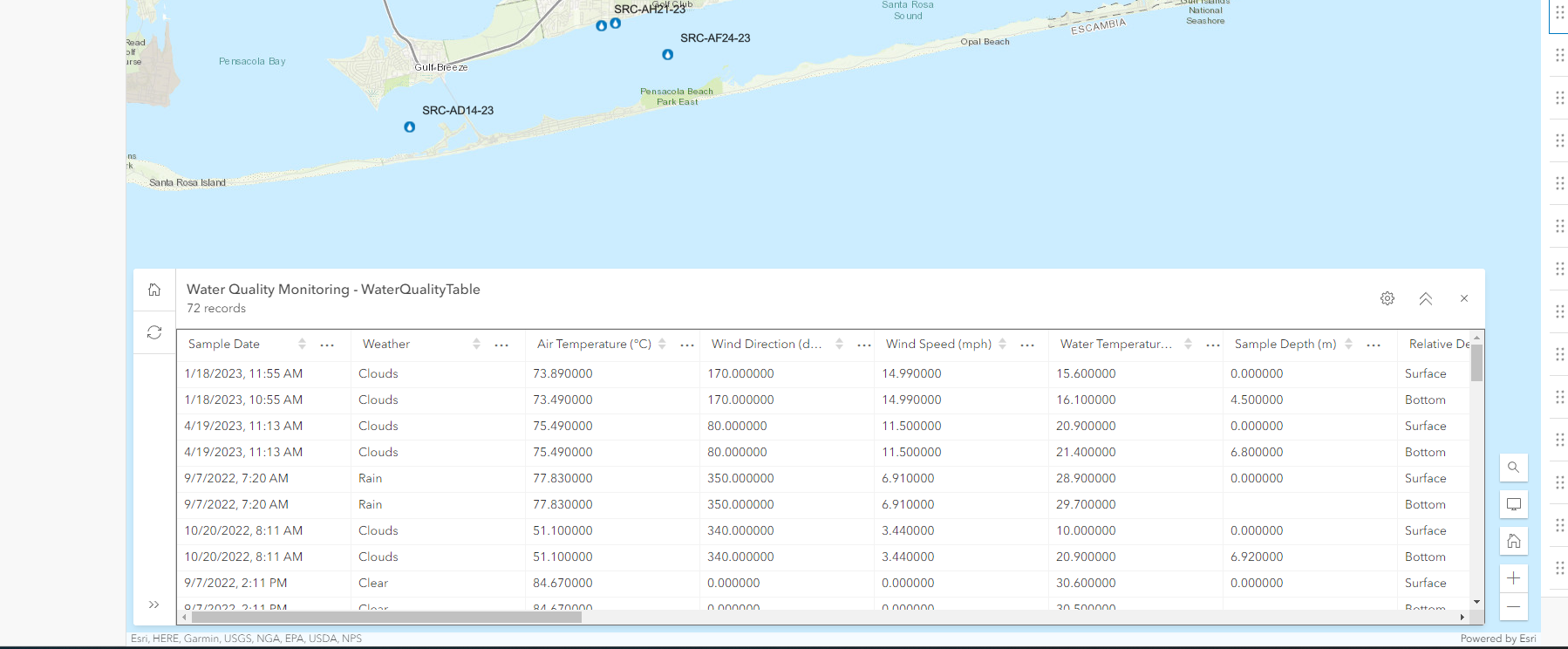

MFazio
Now that you mention it, when I open in the Pro, I see the rounding is set to 6 decimal places, which must be the problem. I'm still struggling with an 'int' field that is displaying with 6 decimals...

MFazio
Thanks, I hadn't considered the Visualization tab. I'm now running into the issue of an 'int' field that has 6 decimal places, but AGOL will not allow me to adjust it because it is not a float.
