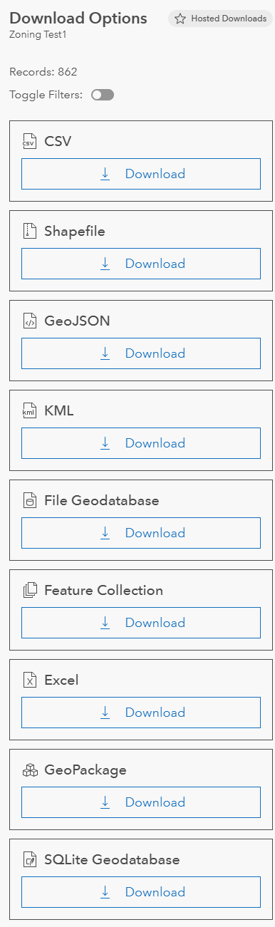

Our goal is to have the public continue consuming our public data through our Open Data site, but using an HFL on AGOL is preferable than having an AGOL reference a local map/feature service, as the HFL allows extra download options in the Open Data site (i.e. File GDB), and also alleviates potential load on our local system when users query or download these datasets (maybe not a big impact, but it's something).

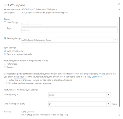

Testing has shown the process of sharing a LFS (versioned, globalid, editor tracking, sync enabled) with the properly established Distributed Collaboration (DC) workspace/group in our Portal can replicate our LFS data to AGOL as a HFL copy. We have specified settings of the DC to establish one-way replication/sync, rather than two-way, for this purpose. It really does seem to behave like a replication service. It preserves the globalids of the source features, and the item that gets spooled out in AGOL has the same content ID as the item in Portal.
Testing shows that Insert/Update/Delete edits on the LFS side are automatically pushed to the HFL on a schedule that can be customized (although any schema changes on the LFS side would need to be updated manually on the HFL side). Basically… it works!
