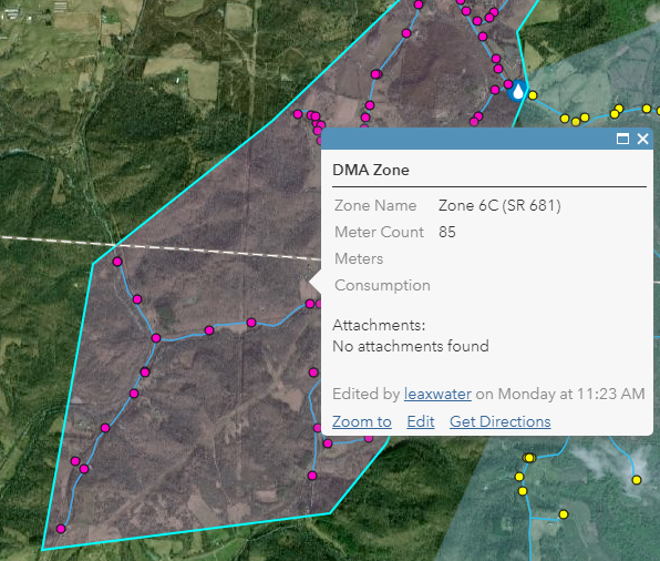

This is related to water consumption and waterloss to add context. I have the following two layers in my map:
   -Zones
   -Meters
I've been trying to make this work in Arcade, but can't exactly figure out how. I have figured out how to Count the meters contained in the "zone" as shown below in the map with the pop-up, but I also want to display the total of the field "Consumption" of all the meters contained in that polygon/zone. So if I had a Zone and there were 5 meters in the zone, and each customer consumed 1,000 gallons, I want to display 5,000 gallons on the pop-up for that Zone.
var meter = FeatureSetByName($map,"METERS")
var CountMeters = Count(Intersects(meter, $feature))
Return CountMeters
I'm focused on using the "(Intersects(meter, $feature))" with the function of SUM, but I'm not sure that's the right direction. In words, I want to find all the features from the Meter layer that are contained in the polygon Zone, and then total the attribute field "consumption" of those objects. I'm looking for the total water consumption within that Zone. I can only find examples of counting objects using the Intersect function, but not totaling fields using the Intersect function.
Any help would be greatly appreciated.

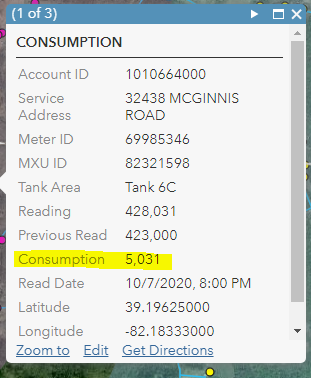

Attibute table for a Meter:
DMA Zone and Meters:

It seems that for some reason the consumption field in the services featureclass was renamed to "consumptio" (without the "n"). If you change that twice in the code (lines 2 and 17) it should work:
// access the meters featureset, limiting the fields to Consumption
var meters = FeatureSetByName($map, "Services", ["Consumptio"], False);
