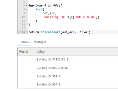

First things first: don't forget about the "code sample" button on here.
Second, you can definitely add line breaks like that. You could just take the current script and include two newlines at the end of your popupResult += ... line.
However, this method is a bit less than idea, because it creates space at the end of your popup that you don't need. I would suggest making use of the Concatenate function. Instead of building the popup string in your loop, just append to an array, and then generate the string from that.
Also, I like to suggest the use of template literals whenever possible, because it's just easier to read than all those + and " characters.

return Concatenate(out_arr, '\n\n')
And here's me testing it on a sample layer:
