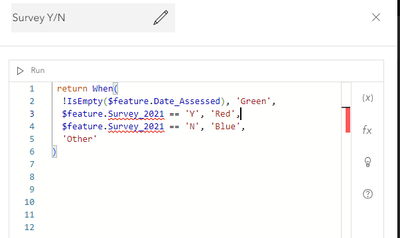

HarryBell
Hi Josh
Wow - that makes it look easy!  I've tried putting it in as is, but it has the red blocks and doesn't let me save it - have I missed something?  Thanks for your help!
jcarlson
MVP Alum
Does the editor show you a message if you over over the red sections? Usually that would mean there's something wrong with the field name.
If the field really is "Survey_2021", try using bracket notation, like $feature['Survey_2021'] instead. Capitalization counts!
- Josh Carlson
Kendall County GIS
