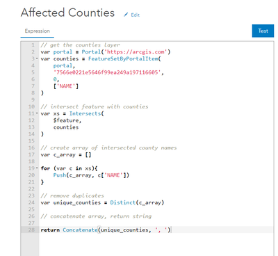

All together, it might look something like this:
// get the counties layer
var portal = Portal('https://arcgis.com')
var counties = FeatureSetByPortalItem(
    portal,
    '7566e0221e5646f99ea249a197116605',
    0,
    ['NAME']
// intersect feature with counties
var xs = Intersects(
    $feature,
    counties
// create array of intersected county names
var c_array = []
for (var c in xs){
    Push(c_array, c['NAME'])
// remove duplicates
var unique_counties = Distinct(c_array)
// concatenate array, return string
return Concatenate(unique_counties, ', ')

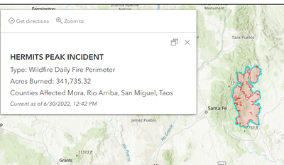

And here's what it looks like in action:

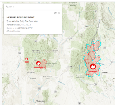

Thanks for your response @jcarlson!
I put in the code and set up the pop-up but I'm still not seeing any of the county names. Any ideas?
jcarlson
MVP Esteemed Contributor
Double check how the popup itself is configured. Are you referencing {expression/expr2} (or whatever the expression number is) in the popup text? I can't thing why else it wouldn't show up.
- Josh Carlson
Kendall County GIS
AFackler_NAPSG
Okay I got it working. I had to do the old fashioned clear the browser cache/ try in another browser and it looks like that did the trick. Thanks for your help!
