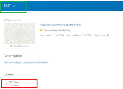

Hi,
I've recently found the arcade GetFeatureSetInfo(GetFeatureSet($feature)).layerName, however I am after getting the alias name or item description rather than the layer name - see screenshot for clarification, I would like to grab the green square rather than the red one
Does anyone know if this is doable please?

cat206
Thanks for the response and the tip!
The feature layer is fed by a python script scheduled to run each day, which truncates and appends the data. We therefore can't amend the layer name, which is what the GetFeatureSetInfo grabs in the console. The alias and description is updated by the python script to say the last date and time the layer was updated, therefore it'll change daily. When adding the feature layer to a map, the alias doesn't get updated in the content as it's static, so i wanted to add an arcade expression to grab this info into the pop-up. I hope that make sense but looking at the arcade documentation, there doesn't seem a way to obtain the alias FeatureSet functions | ArcGIS Arcade | Esri Developer
