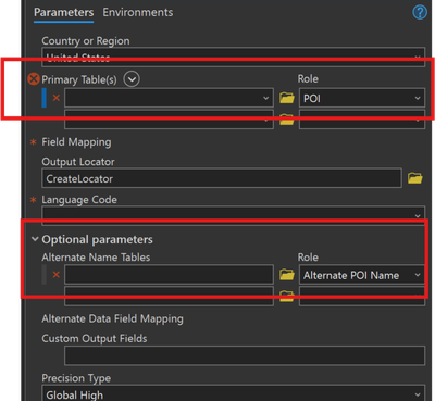

My initial thought is to use Create Locator in Arc Pro. Include in your table an alternate name field with no special characters. Use the Point of Interest Role.
Just a quick thought to get you started.

Hi @Roger_Schulz, thanks for the reply.  I did think about a Locator as they seem to behave differently and return results with apostrophes even if you omit them from the search term.  However, we're using the Search function against the Buildings layer as we want to select the feature to show information in a popup, not just pan/zoom the map to the feature (which is all a Locator will do).

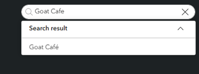

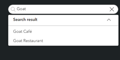

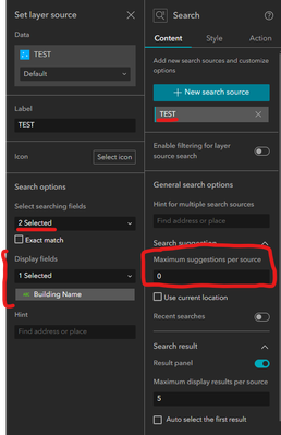

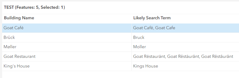

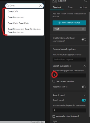

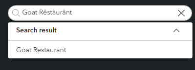

gis_KIWI4
@MappyIan - Would you use the experience builder search widget?
This may be helpful but it requires turning off search suggestions which are autopopulated when the user is typing. This builds on the second suggestion. The downside is that you need to press enter for the search results.
Data -
This is what it looks like -  
Setup of the ExB Search Widget
Maybe this could work for you.
I wish there was a way to control what's displayed in the search suggestions.
