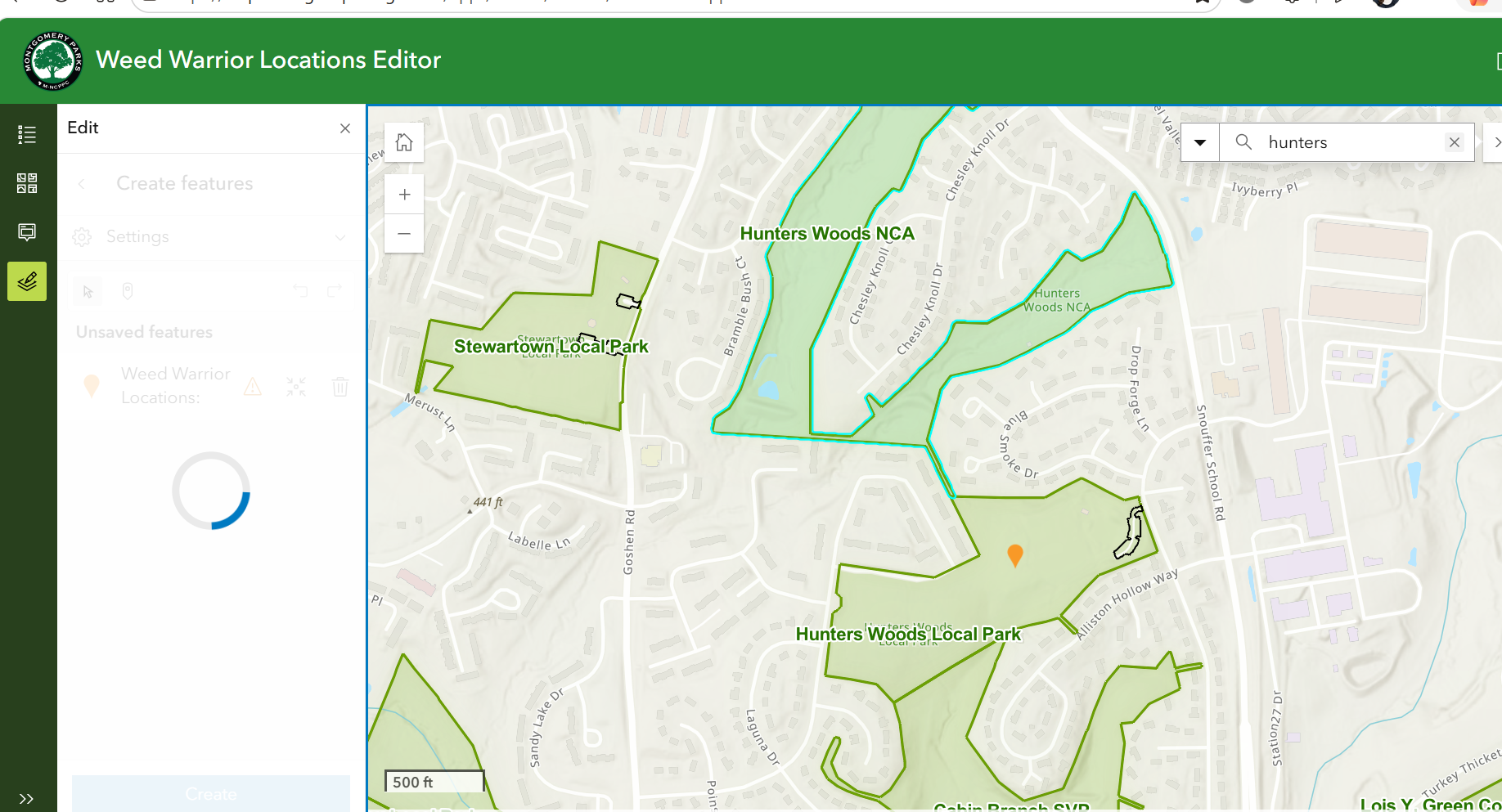

Before the June 2026 update, this Arcade expression worked completely fine in returning the intersecting Montgomery County Watershed ID. I have isolated the issue to being the First function. The layers, the intersect expression, everything works but stops once the First function is introduced to yield the first item in the FeatureSet and thus its attribute value to be returned. The First function now results in a continuous loading spin if a point is placed in a location where a intersect is yielded.

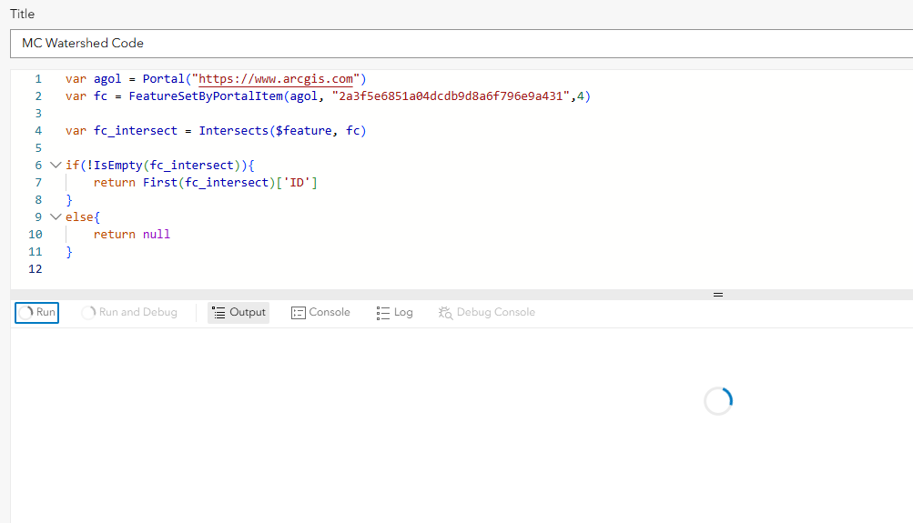

Expression as is:

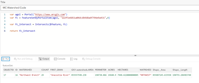

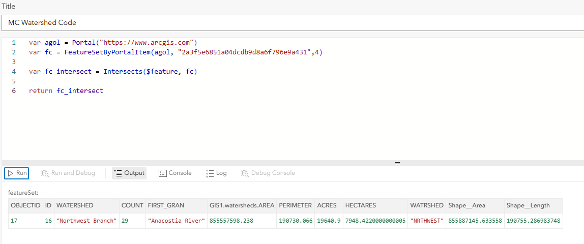

Expression without First function, demonstrating the Intersects and preceding functions work:

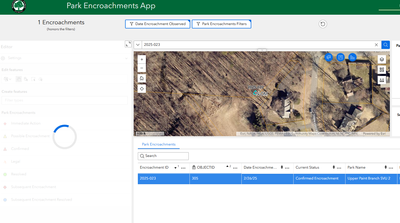

This is how it looks in the Instant App editor:
Arcade code:
var agol = Portal("https://www.arcgis.com")
var fc = FeatureSetByPortalItem(agol, "2a3f5e6851a04dcdb9d8a6f796e9a431",4)
var fc_intersect = Intersects($feature, fc)
if(!IsEmpty(fc_intersect)){
    return First(fc_intersect)['ID']
else{
    return null
This should be replicable with any editable layer given that the source layer for the intersect, Watersheds used by Hansen (M-NCPPC), is publicly shared.

@timcneil this issue is still active as of this morning. Any expression with the First function freezes and thus if used, locks all editing within the smart form aware editing sessions.

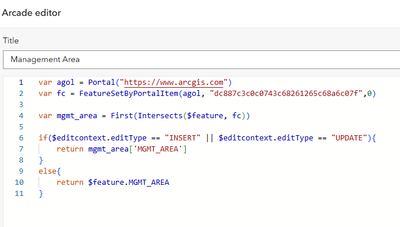

The above has a few expressions that use first since it is the easiest way to grab the result of an Intersects, or other spatial operations, in Arcade expressions on a FeatureSet.
I will update my sister case to this thread. Thanks for being responsive. Fortunate there is an equivalent method of grabbing this data using a loop but customers like us at Montgomery Parks will be playing wack-a-mole considering how commonly used the First function is or let editing sit idle until resolved.
