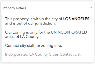

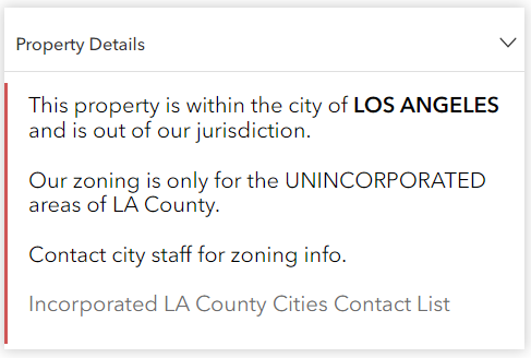

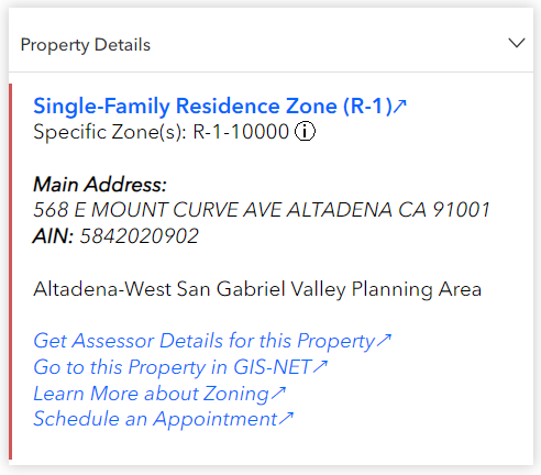

Popup 1
Popup 2
The app using the web map with this code is currently private. Is it still possible to assess if this was the best way to write this code? Or is there a way to improve so it processes faster?

BrandonPrice1
Hi Ken. Thank you. The first part which checks if the TaxRateCity is unincoporated runs a lot faster now that it runs first. The template literals make the code cleaner although may have not impacted the processing speed one way or the other. I still could not get the second half to run without using the loops in the original code so that processing time is the same. I will keep taking a look.
