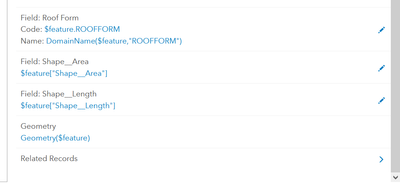

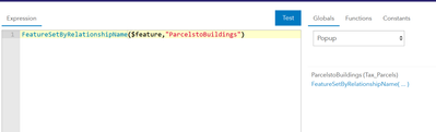

jcarlson
MVP Alum
Oh, gosh. When I copied my code in, I forgot the last line:
return output
Add that to the expression I posted, it should return something.
And take a look at FeatureSetByRelationshipName. When you use that to access the related data, it is pre-filtered to those related items. You'll need to know the relationship name, or use the expression builder to pipe it in.
- Josh Carlson
Kendall County GIS
