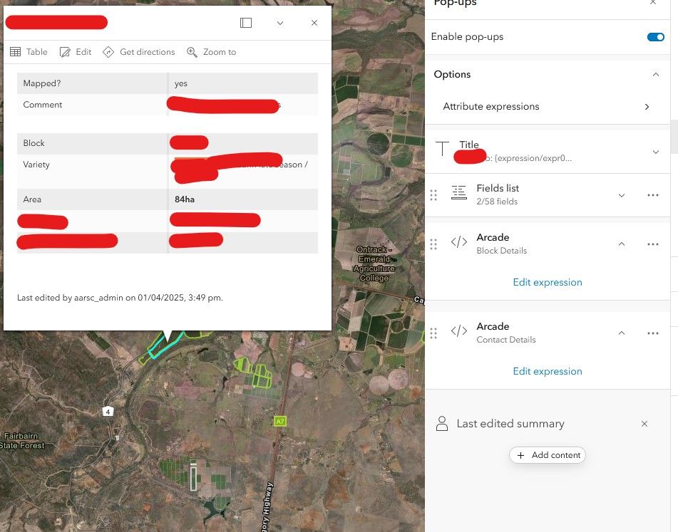

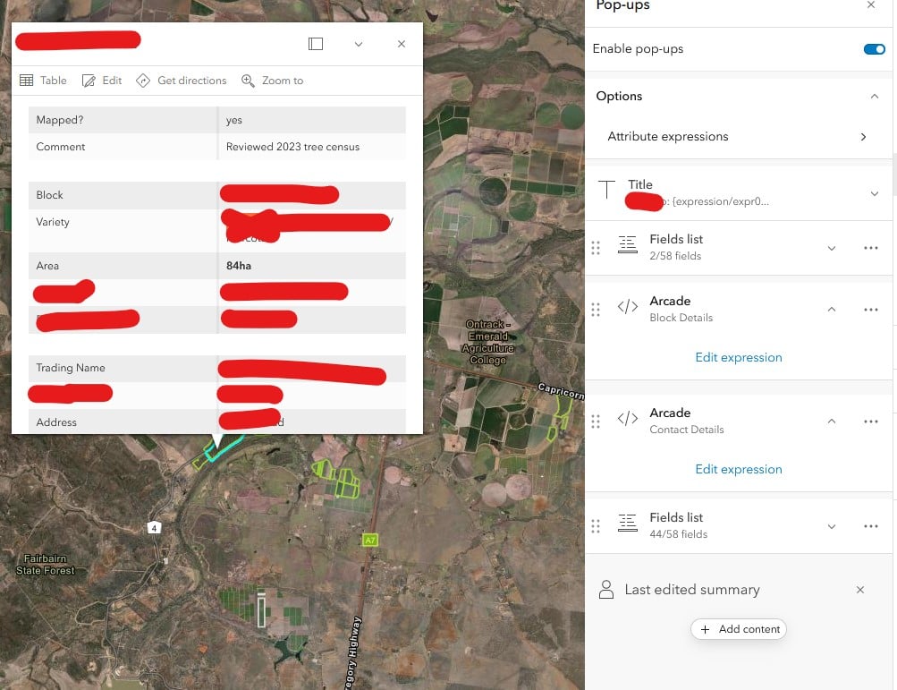

I have a couple of arcade elements creating the fields list in a Map Viewer popup. There seems to be some issue displaying/running the elements under certain circumstances:
  • I'm experiencing one element just not appearing
  • while another element seems to not recognise a code change I have made.
If I add a standard fields list element into the popup, these issues disappear and the popup behaves as expected. If I remove all the fields from the fields list, or just remove the fields list entirely, the issue reoccurs, including the code change no longer being recognised.
Screenshots attached only show the element disappearing entirely.2elements-problem.jpg3elements-noproblem.jpg
EDIT: With a little bit more playing I'm now not able to display any values via an arcade fields element unless they're already being displayed in a normal fields list. Ie. I can control which portions of my arcade elements work based on the attributes I display in a standard field list.
There's something wrong with the rendering profile I guess.
