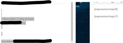

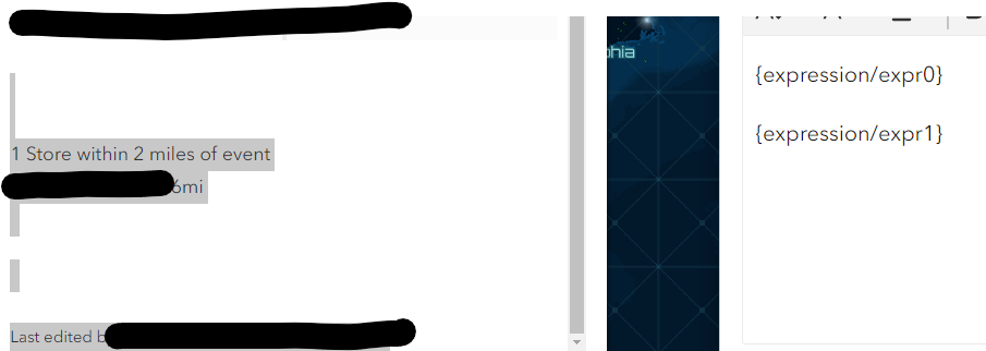

I have two expressions that are essentially the same and both are functional when testing them but when loading them into the popup only exp0 loads.

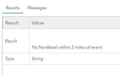

Here is the expression, less the ID.  The console expression does work and loads the correct number.  You'll see from the picture the line is there for the popup but nothing is displaying.

In lines 17 and 21, you're using rStores instead of nrStores, that might be it...
