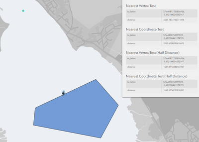

TimF
Hi Johannes,
Thanks for the response. Good shout on the null check and specific dictionary response.
I did get these functions to work on different test data i.e., a new layer with a single point, comparing to another new layer with a single polygon. I'm not sure what was wrong with my hosted layers... but this at least allows me check the accuracy of the outputs.

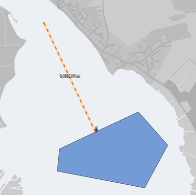

Do you happen to know if the distance returned is source->target->source (i.e., double-counting)?
I found the Nearest Coordinate distance, when divided by two, returned the closest distance to the true distance calculated in Pro (and shown with the Measure tool). However I wasn't sure if that was a rule-of-thumb I could rely on....
Thanks!
JohannesLindner
MVP Alum
The coordinates suggest that you are using a geographic coordinate system. For distance measurements, you should use a projected coordinate system.
Have a great day!
Johannes
