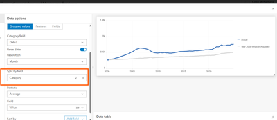

I ended up republishing a zip code layer with a standalone table along with it. The table had 20,000 records associated with 80+ zip code polygons with a category field (Actual v. Inflated) and used that to group my features. This allowed me to create two lines in a series (see image).

I am actually not using arcade. I added a category field to show two series - Actual & Inflation Adjusted.
