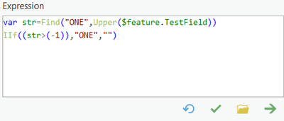

Check this out
var str=Find("ONE",Upper($feature.Attribute))
IIf((str>(-1)),"ONE","")
