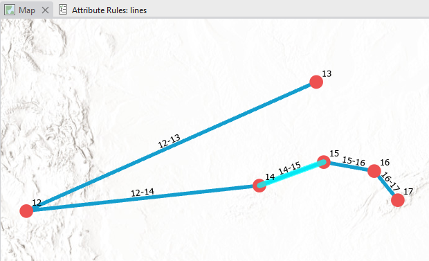

I attached a screenshot as an example.

using Attribute Rules you could do something along the lines of this:
var pole = FeatureSetbyName($datastore,"points",["Name"])
var line = buffer($feature,.1)
var ab = Intersects(pole, line)
var line_name = ''
for (var a in ab){
var pole_name = DomainName(a, "Name")
line_name += pole_name +'-'}
return left(line_name, count(line_name)-1);
You could also calculate the values after the fact, if you are not able to use attribute rules (e.x. using ArcGIS Online Hosted Feature Layers)
The is what it looks like labeling the created features in ArcGIS Pro
