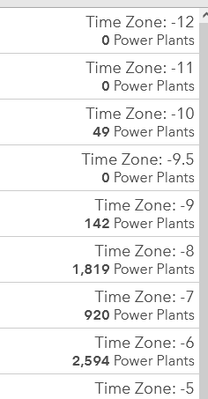

It really depends on where in the Dashboard you're using Arcade, and what exactly you're trying to do with it. If all you want is a list with a count in it, that's not terribly difficult, but accessing other layers in a Dashboard Arcade profile does require a bit more work than usual.
This example should give you a good idea:

And the output:
