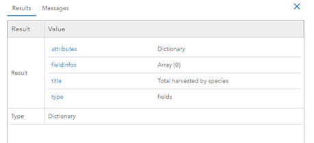

And the result:

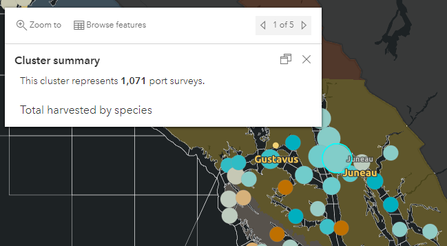

And the view in the pop-up:
Does anyone have thoughts on why this may not be working based on the info I shared?

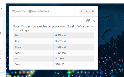

Dang... now I'm going to have to look at it closer.... I found the sample map viewer project the original code you borrowed from was based on (I don't have good cluster data to test against).
Power Plants around the Globe (arcgis.com)
I then copied your code in a custom clustered popup in that project and just changed the attribute names back to the names from the original code your borrowed from (I.E. your code with just field names changed). And.... it worked :-(.
I would have preferred if it didn't because then I would have something to solve for.
Here's the code I used if it helps.  Maybe I changed something small like a comma or capitalization without realizing it.  Hope this helps.  If nothing else, the fact that it works might provide a clue.
