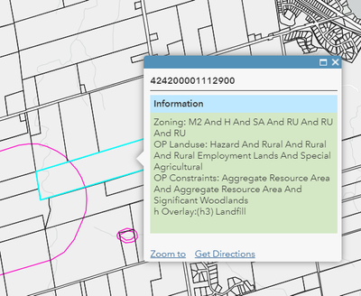

intersect (pink is 'h overlay')

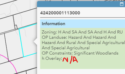

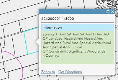

no intersect

So where it says "Hazard", it should say "n/a", right? Or is "Hazard" a land use?
Can you post the code you used, please?

aroininen
Hello!
No I want it to show n/a after 'h Overlay"  as it is outside of zone
Thanks
