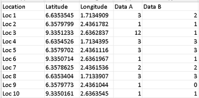

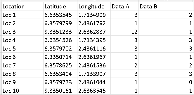

I want to make a conditional display with the data of a table in the form of dots of different colors. Each row of the table contains columns with x and y coordinates and A and B data. I want an arcade code to display the data on the map as follows:
- if A is greater than B, then display the points in yellow
- if A is equal to B, then display the points in blue
Can anyone help me?
Thank you for your help.

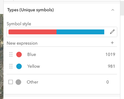

Simple enough! Keep in mind that when working with Arcade for symbology, you will get categories.
Iif($feature.A > $feature.B,
  'Yellow',
  'Blue'
It's still up to you to go into each category and adjust the color.
