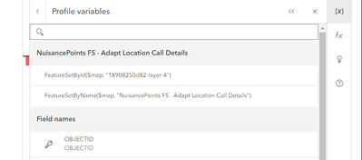

var RelRecs = FeatureSetById($map, "18908250d82-layer-4")
var RelRecs = FeatureSetByName($map, "NuisancePoints FS - Adapt Location Call Details")

I want to use the $map functions to create a similar filter based on retrieving a matching ID value from a different layer in the map. However, both the code lines return feature set with 0 records, since this is the first line of the code block, nothing that follows is relevant. The lines of code are taken directly from the profile variable so I'd think they should function properly.
