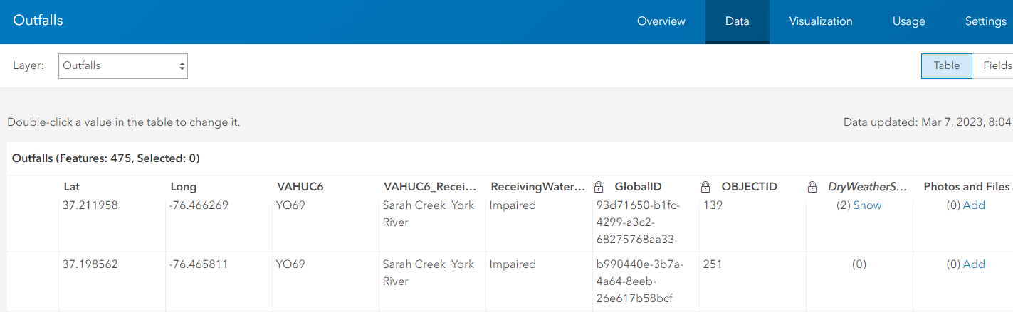

Parent layer "Outfalls", showing the GlobalID for NodeNumber WOC_24OF0_00.

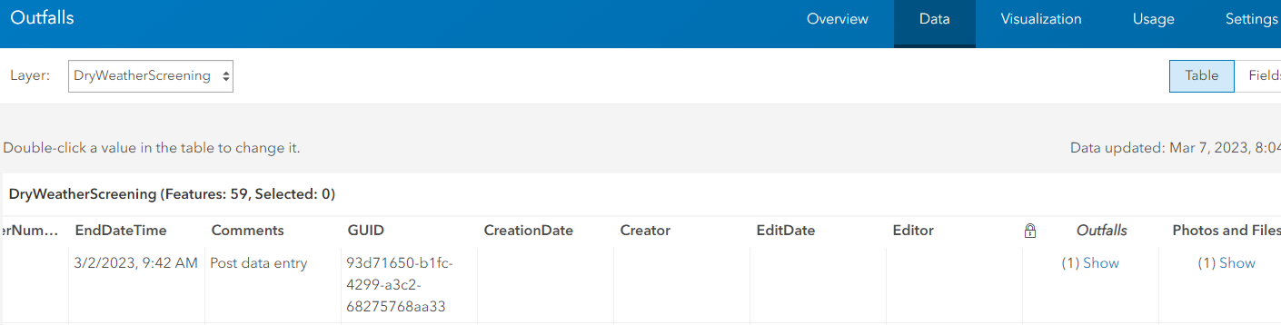

Child layer, "DryWeatherScreening" showing the GUID field for WOC_24OF0_00, same as the parent layer's GlobalID.

JohannesLindner
MVP Alum
To post code:
You didn't adapt the filter query to your data. This should work:
// Filter related features by using a common attribute
var globalid = $feature.globalid
var filterStatement = 'GUID = @globalid'  // GUID instead of parentglobalid

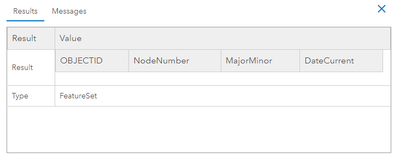

I tried this below (excluding the pop-up section for now), and it doesn't pull any values.
// Access 'Groundwater Levels Monthly Mean' table as a FeatureSet
var waterLevels = FeatureSetByPortalItem(Portal('https://www.arcgis.com'),
"4b21a92f2b38444793cf1ae1192476e4", 3, ['NodeNumber', 'MajorMinor',
'DateCurrent'])
var GlobalID = $feature.GlobalID
var filterStatement = 'GUID = @GlobalID'
// Related features as a variable
var relatedData = Filter(waterLevels, filterStatement)
// Sort related features by oldest to newest
var relatedDataSorted = OrderBy(relatedData, 'DateCurrent DESC')
return relatedDataSorted
NorthSouthGIS
It is returning the related data but as a featureset, you need to parse it out. See solution here: https://community.esri.com/t5/arcgis-online-questions/display-related-records-in-a-popup-in-a-nice-t...
