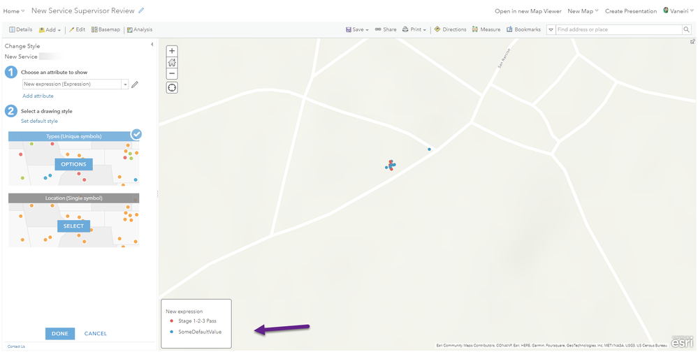

@JohannesLindner , thanks for the feedback. I forgot to mention that Stage 3 will be empty if either Stage 1 Fails and Stage 2 Fails. This stage 3 will be "Pass" only if both Stage 1 and Stage 2 pass. Otherwise, it will be empty.
I tried to re-write the expression by leaving it empty in the quotations but it returns "SomeDefaultValue" rather than the variations I state.
var Stage1= $feature.inspectionresult
var Stage2= $feature.installationresults
var Stage3= $feature["ns_serviceentrance"]
return When(
Stage1=="Pass" && Stage2=="Fail" && Stage3==" ", "Stage 1 Pass Stage 2 Fail",
Stage1=="Pass" && Stage2=="Pass" && Stage3=="Pass", "Stage 1-2-3 Pass",
Stage1=="Fail" && Stage2=="Pass" && Stage3==" ", "Stage 1 Fail Stage 2 Pass",
Stage1=="Fail" && Stage2=="Fail" && Stage3==" ", "Stage 1-2 Fail",
"SomeDefaultValue"
I also tried entering "NULL" and still got the breakdown as on image.
