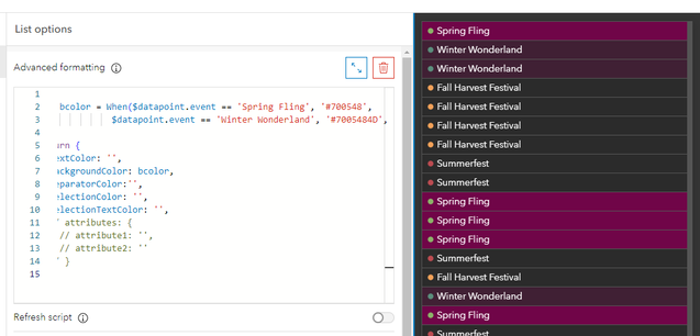

Hello,
Any thoughts on how to be able to set the transparency of the cell background color (cellBgc) in lines 12 and 13?
Thank you
JenniferAcunto
I personally add the transparency to the hex code. The transparency value goes at the end. So if I wanted to add 70% transparency to this color #700548, I would add 4D to the end to get #7005484D.
Hexadecimal color code for transparency
- Jen
JenniferAcunto
- Jen
JeffreyLenard
Thank you very much Jen, that worked!
Jeff
