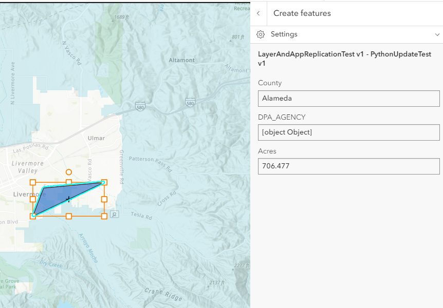

I have a python script that creates several views of a layer, duplicates a template map and app, and then drops the new view into that map/app. Part of the equation is an Arcade expression in the template map. In the template map it works perfectly, taking the largest overlap of an underlying layer and applying it to a field. However, after the script creates a view, duplicates the map and app successfully and imports the form this expression returns [objectObject] instead of the appropriate overlap. The expression works appropriately when tested in Arcade editor, but not when actually editing the dataset.
It should be noted that two other Arcade expressions are duplicated in this process and they both execute fine (calculating the 'County' and 'Acres' fields, see image below). It's only this 'largest overlap' calculation that fails upon duplication.

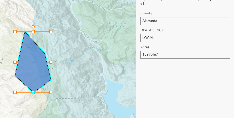

The result in the template map, where it calculates appropriately:

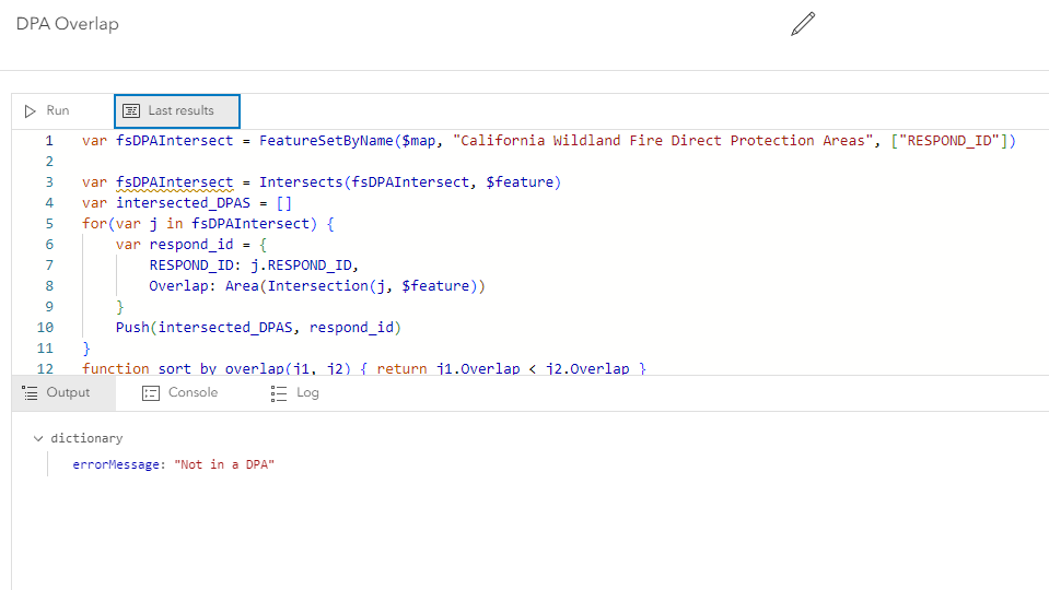

The duplicated map's Arcade editor:
Duplicated map's results:
Note how the calculations for 'County' and 'Acres' still fires appropriately.

Disregard!
I found my issue - when I add the queried layer to the newly replicated maps I had a spelling error so the calculation didn't recognize it when called to the map.
