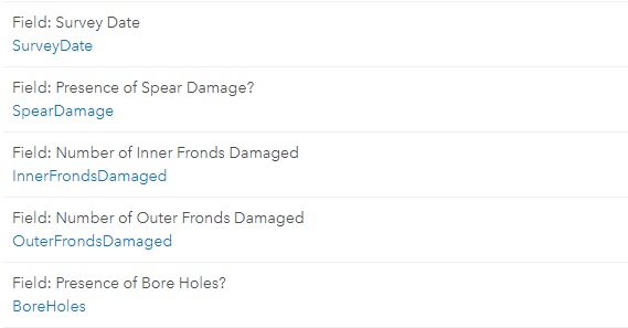

Hi all! I am somewhat new to using Arcade and need some help to populate a field based on the most recent related record.
The field I would like to populate is CRNT_DAMAGE from the newest related record "Individual Palm Damage Survey" based on the field "SurveyDate".  The condition I would like met is if "SpearDamage" and "BoreHoles" == No as well as "InnerFrondsDamaged" and "OuterFrondsDamaged" == 0, then the return value would be "No" for CRNT_Damage.  All else would return "Yes".
Please comment bellow if you have suggestions or can refer me to a similar expression.
Thank you all!

Judging from the fields, you are writing this expression in the palm survey table. But it should be written for the palm layer.
Have a great day!
Johannes
