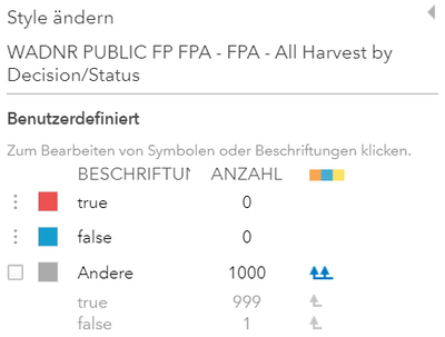

Then you can change the legend labels:
And that's it.

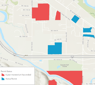

L77
Thank you so much, I really appreciate the help!
