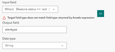

 I keep getting this error when I test the arcade expression - Test execution error: Compilation error - Line : 1, 0: Call with wrong number of parameters. Verify test data.
I get this error on the velocity side -
 I would appreciate any thoughts or assistance as I try to figure out

The first When statement is missing the DefaultValue
When(
  $feature.status == 'action', 'Action Stage',
  $feature.status == 'minor', 'Minor Flood Stage',
  $feature.status == 'moderate', 'Moderate Flood Stage',
  $feature.status == 'major', 'Major Flood Stage',
  'N/A')

Bryan_Wade
Thanks for the help! That did the trick. I'm new to using arcade and really appreciate the assistance
