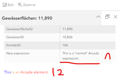

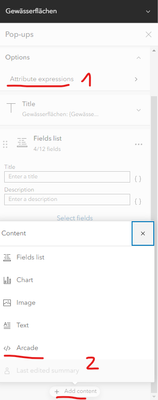

Based on the working default code, you're trying to add an Arcade element. For that to work, you need to return a dictionary (documentation). In your actual expression, you're not doing that, instead you return a string.
There is a difference between a "normal" Arcade expression (#1 in the images) and an Arcade element (#2). The value of a "normal" Arcade expression can be shown in the fields list. The Arcade element is more customizable, and, as said, you need to return a dictionary.

Thanks for pointing me to the right direction Johannes. I tried my code in an expression and as an element, for some reason it was not working in an expression, now it does. And your code works with the element.
