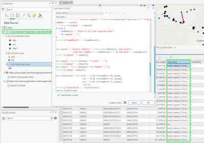

 i am using this expression to check if a line is intersecting two point feature layers and return an expression to run a specific type of subduct between each feature. the expression works as expected in the pop up but when i try to run it in the field calculator it fails with the expression
"Cannot read property 'length' of undefined error"

The field in question is "Test_Note , feel free to try, i tried previously in Pro but could not get it to work either.

No luck here either, but I think it is due to the access to the pole and chambers featuresets. To compare in the pop-up the expression worked since I can access the layers from the map by their names. However, the map is not available in a Field Calculation and the chambers and poles are not in the same datastore. That is why I assume you tried to access the layers using FeatureSetByPortalItem. However, I don't think I am able to get access to these layers, since I am not part of the portal where the layers are stored.
When you try your expression in a pop-up and you access the layers using FeatureSetByPortalItem, does the expression work, or does it return an error. I noticed the error when I try and do a Count on the layer to see if it returned something and that throws an error in my case.

I just did a test with the expression after copying the data to a local file gdb and ran the expression after changing the access by $datastore and the expression just works. It must be due to the portal access to the two layers that is causing the problem...
PaulSweeney3
Thanks @XanderBakker it is working for me now and the good news is the pop up is working in the field maps app so i can use it in that for our field crews. Really appreciate the help on this , I  applaud your efforts to support everyone on this page with arcade quieres  it really is very helpful. Well done.
