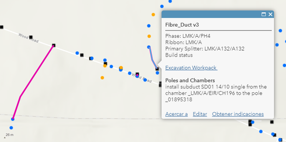

 i am using this expression to check if a line is intersecting two point feature layers and return an expression to run a specific type of subduct between each feature. the expression works as expected in the pop up but when i try to run it in the field calculator it fails with the expression
"Cannot read property 'length' of undefined error"

It is strange that if you only have a single feature, the expression works correctly but the field calculation fails. how are you filtering the featureset? Did you create a new source? It is possible that the pop-up validator is more forgiving than the one used in the field calculation...
PaulSweeney3
Hi @XanderBakker
My turn to apologise for the late response , i have tried you expression and i am still getting the same error unfortunately . Just in response to some of your comments
The when statement , in theory there should only be 2 features intersecting the line at either end and it should be a pole or a chamber so 5 potential scenarios. Would this account for the error ? where it is  only 1 pole or chamber  i don't need a value i thought this would return just 'n/a'

// does you code include the layerID for poles?
Yes my code contains the layer ID for the poles and chambers
why is this an underscore?
No major reason  had it as a blank but then i thought perhaps the blank value was creating the issue so i just tried it with an underscore
I filtered it down to one objectid i knew worked with the pop up?
A new source? do you mean re publish the feature layers ?
Thanks for your help on this

Can you indicate what should be changed?
PaulSweeney3
Hi @XanderBakker  yes this is expected it works for me in the pop up as well however when i try to calculate a field with  the same expression  it doesn't work. i shared the test map in there now but i understand you do not have the ability to calculate fields via arcade
