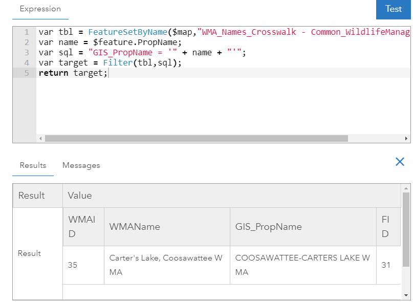

I'm working with a feature layer and a separate table that have a column in common (many to one relationship). The feature layer common field name is PropName and the table field name is GIS_PropName. I'm attempting to use FeatureSets to get the value of a second field called WMAName using Arcade. I can get as far as the below but when I change the last line to:
return target.WMAName;
I get the following error. Execution Error:Runtime Error: Cannot call member property on object of this type. WMAName

In this case target is a collection of records, which might only have one record. You can do something like this:
var target = First(Filter(tbl, sql));
// or
var target = Filter(tbl, sql);
return target[0].WMAName;

Thanks Xander. That first method worked.

I'm glad it worked. Just remember that the filter will return a collection even if the collection contains only a single record. You will have to drill down to the record to be able to query the individual attribute values.
