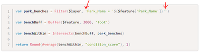

ArmstKP
Thank you very much Josh!
I have a question about two of the characters I have pictured below.  What are these?
jcarlson
MVP Alum
Ah, those are called backticks. You use them in Arcade (and other programming languages)  to create template literals.
Suppose you had two variables you wanted to pipe into some text. You could just concatenate the text like this:
var x = 'something'
var y = 'something else'
'Variable x is ' + x + ', and variable y is ' + y + '.'
returns:
'Variable x is something, and variable y is something else.'
But a template literal inserts the variables directly into the string.
`Variable x is ${x}, and variable y is ${y}.`
Both work, but I personally prefer the backtick style, as I find it easier to use and visualize the resulting string.
