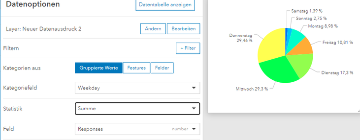

Use that Data Expression in a pie chart (show percentage of responses on each weekday):

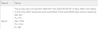

I tested this with a layer that spans 15 years. The for loop took way too long, so I used a GroupBy to get the count of responses on each distinct date. That massively shortens the for loop but it means that we have to calculate the workdays instead of counting them.

// group the featureset by date, get count
// convert to text to remove time
var extract_date_string = `CONCAT(EXTRACT(YEAR FROM ${datetime}), '-', EXTRACT(MONTH FROM ${datetime}), '-', EXTRACT(DAY FROM ${datetime}))`
var grouped_by_date = GroupBy($layer,
    [{name: "DateString", expression: extract_date_string}],
    [{name: "Count", expression: "1", statistic: "COUNT"}])
// loop through the grouped records and fill weekday bins
var weekday_bins = [0, 0, 0, 0, 0, 0, 0]
for(var row in grouped_by_date) {
    var date_parts = Split(row.DateString, "-")
    var current_date = Date(date_parts[0], date_parts[1]-1, date_parts[2])
    var iso_day = IsoWeekday(current_date)
    weekday_bins[iso_day-1] += row.Count
// get total responses and days without response
var responses = Sum(weekday_bins) // same as Count($layer)
var days_without_response = days - Count(grouped_by_date)
// return
var return_lines = [
    `The survey was running from ${Text(first_date, "Y-MM-DD")} to ${Text(last_date, "Y-MM-DD")} (${days} days, ${workdays} work days).`,
    `In this time, ${responses} responses were submitted. There were ${days_without_response} days without response.`,
    `Mo: ${weekday_bins[0]}`,
    `Tu: ${weekday_bins[1]}`,
    `We: ${weekday_bins[2]}`,
    `Th: ${weekday_bins[3]}`,
    `Fr: ${weekday_bins[4]}`,
    `Sa: ${weekday_bins[5]}`,
    `Su: ${weekday_bins[6]}`,
return Concatenate(return_lines, TextFormatting.NewLine)

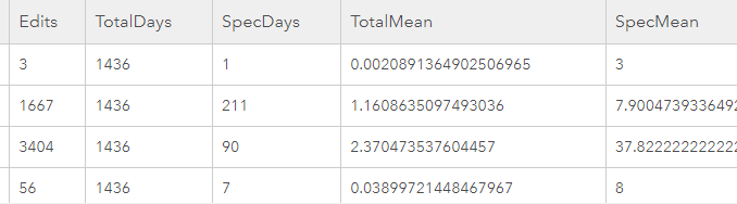

One more quick question if I may ask.  I have no problems trying to hash it out, but I figure I would ask in case there is as simple way to do it from what you have already done (as I said, your code writing is like an art form).  My ultimate goal is to essentially average out the amount of records a person did a day over a full years worth of data.  So, the final result is just one number that shows at the end of the year, this person (based on something like the 'Editor' field) was able to do *said number* a day.  Have any suggestions or best practices to pull this off, especially if it was to pull the names dynamically?
JohannesLindner
MVP Alum
Everything you need is actually already in my scripts, we just need to rearrange a little. You could do something like this:
// What is your datetime and name field?
var datetime = "AngelegtAm"
var name = "AngelegtVon"
// function to get mean edits per day over the whole period
function total(fs, user) {
    var first_datetime = First(OrderBy(fs, datetime))[datetime]
    var last_datetime = First(OrderBy(fs, datetime + " DESC"))[datetime]
    var first_date = Date(Text(first_datetime, "Y-MM-DD"))
    var last_date = Date(Text(last_datetime, "Y-MM-DD"))
    var days = DateDiff(last_date, first_date, "days") + 1
    var edits = Count(Filter(fs, `${name} = @user`))
    //return edits / days
    return {edits: edits, days: days, mean: edits/days}
// function to get mean edits per day where the user actually edited
function specific(fs, user) {
    var fs = Filter(fs, `${name} = @user`)

To show the difference between the functions:
// Load data
var p = Portal("...")
var id = "b19c6cfbacaf46489495b5b896ad9490"
var lyr = 16
var layer = FeaturesetByPortalItem(p, id, lyr, [datetime, name], false)
layer = Filter(layer, `${name} IS NOT NULL AND ${datetime} IS NOT NULL`)
// get users
var users = Distinct(layer, name)
// create output featureset
var output_fs = {
    fields: [
        {name: "User", type: "esriFieldTypeString"},
        {name: "TotalDays", type: "esriFieldTypeInteger"},
        {name: "SpecDays", type: "esriFieldTypeInteger"},
        {name: "Edits", type: "esriFieldTypeInteger"},
        {name: "TotalMean", type: "esriFieldTypeDouble"},
        {name: "SpecMean", type: "esriFieldTypeDouble"},
    geometryType: "",
    features: []
// fill the output featureset
for(var user in users) {
    var total_mean = total(layer, user[name])
    var spec_mean = specific(layer, user[name])
    var new_feature = {
        attributes: {
            User: user[name],
            Edits: total_mean.edits,
            TotalDays: total_mean.days,
            SpecDays: spec_mean.days,
            TotalMean: total_mean.mean,
            SpecMean: spec_mean.mean
    Push(output_fs.features, new_feature)
// return
Featureset(Text(output_fs))
