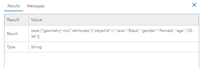

I have this code which bring different fields from another layer to pop up but I can't get the result on popup
var fips = $feature["parent_id"]
var dd = FeatureSetByName($map,
"Survey v2", ['age','gender','race'],False)
var fillterSur = "survey_id = @fips"
var cou = First(Filter(dd, fillterSur))
var popupTEXT = "Age: "
+Text(cou,'#,###')
var popupTEXT = "gender: "
+Text(cou,'#,###')
var popupTEXT = "race: "
+Text(cou,'#,###')
return popupTEXT
The result I am getting is like this :

You have to provide the appropriate field to show for each statement.
var popupTEXT = "Age: " + cou.age; //you don't need to use Text formatting in this line since the value would be "25 - 34"
var popupTEXT = "gender: " + cou.gender;
var popupTEXT = "race: " + cou.race;
If  you want all three values in the same popup, this is one way of doing so
var popupTEXT = "Age: " + cou.age + TextFormatting.NewLine +
                "gender: " + cou.gender + TextFormatting.NewLine +
