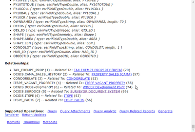

You can use the FeatureSetByRelationshipName function to return the related records for a feature.
var related = FeatureSetByRelationshipName($feature, 'your relationship name');
if (Count(related) > 0) {
  var record = First(related);
  return record.Status;
You'll need to know the Relationship name, which is found in the feature layer's service page (like this one)
RiainGarcia
Genius! Thank you
