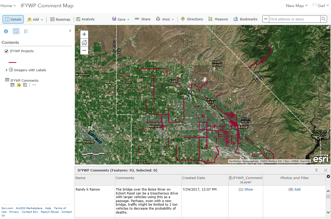

GailJorgenson
Hi Allison,
I appreciate your comments. I double checked with the manager that was reviewing the comments to confirm that the comments were consistent with the project selected in the online app, and he said that was how he will able to go back and reference a project number to a comment, so that indeed worked.
The next step is where things fall apart. I am able to export the feature class to a shapefile and download to my desktop.  When I open the feature class I see 302 records which is exactly the number of records when I published.  I am also able to download the table using the same process.  When I open the related table that I downloaded from AGOL, there are 302 records that same number of records that are in the feature layer.
I was able to get the comment records from the related table by doing some analysis and then exporting. If you are interested in seeing that I can post the instructions, but it was not a straight download from the table in the map.
I have also tried opening the maps that is published to AGOL in the desktop ArcMap, and this error message occurs:
ErrorMessage
Here is a screen shot of the AGOL web map:
Any ideas that you may have about how to get the comments into a spreadsheet format with some identifier would be greatly appreciated!!
Regards,
Gail
