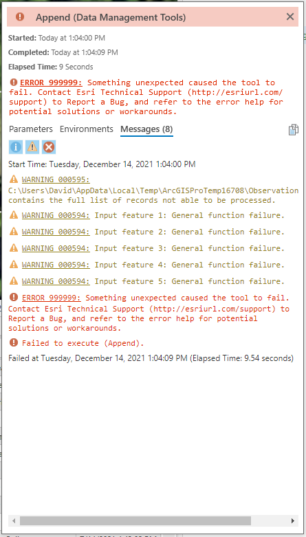

Taking off on the thread found at: https://community.esri.com/t5/arcgis-online-questions/append-data-tool-failing-to-maintain-attachmen... in regard to appending to feature services while maintaining attachment and relationships. Here are the steps I am using to accomplish this. I understand that modifying a local full version of the database and overwriting it to accomplish updates may be offered as a work around. This is less than desirable as a work around because of the potentially large upload sizes, and the inherent risk involved in replacing that many records in bulk. What I detail here is a method for updating parent and child feature service layers in ArcGIS Online through a detailed append operation.
Needed is a destination feature service with at least one parent-child relationship and attachments enabled on both layers. Each layer will also need an additional GUID type field for storing temporary global id's as part of the append process.
The source features an be local FGDB layers or feature services with attachments. While the parent layer can be successfully appended from either a local or another feature service source with attachments intact, none of the child layers will successfully append with attachments intact.

  2. Append the parent layer from the feature service selection or the local FGDB. Do not check maintain Global ID's, as this will cause failure. Do check maintain attachments. Use the field map option if field names do not match between source and target.
  3. For the child layers, the append occurs in two passes, one for features, another for attachments. Append the selected child features without the maintain attachments or maintain global id's enabled as these cause failure. The values in the parentglobalid field of the child layer will be preserved, and will match the values in the temporary GUID field on the parent layer.
