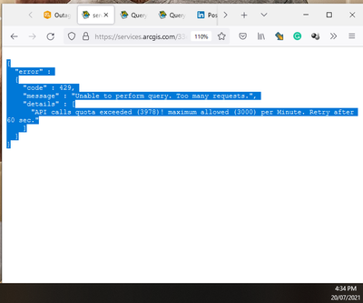

I too am seeing this error on ArcGIS Python API calls that access our ArcGIS Online instance.
<class 'Exception'>: Unable to perform query. Too many requests.
API calls quota exceeded (10002)! maximum allowed (10000) per Minute. Retry after 60 sec.
(Error Code: 429)
I hadn't seen it before today but now have seen it four times.  Retrying after 60 seconds has no effect.

We are getting this error big time intermittently on an ESRI online site https://services3.arcgis.com/....
Has there been any resolution to this?  We can't pin it down.
